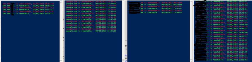

    I have been working with eero support.  I have done a lot of things up to this point.  I have swapped which physical eero was my gateway.  I have factory reset all of my eeros and then started with just 1 eero and only my hardwired laptop connected through it.  that seemed like it had corrected the issue so I moved back to having my Netgear Switch connected to that eero and just my laptop connected to that switch.   I was still having no issues so about 20 minutes in I added my hardwired nas back to the switch and that seemed still no issues so I added my hardwired garage door opener gateway which seemed fine then about 30 minutes in i started seeing the disconnects.  So i removed all the devices back to just my single eero and laptop directly hardwired to it and the disconnects didnt stop.
    When i then recontacted eero support the only First tier step that hadnt been completed was changing the DNS servers for my network to google dns servers which we did and that made no change so its currently escalated to a higher support team.
    I wrote some powershell to ping different addresses and change to red when unavailable,  I have been running this on my hardwired laptop.  The far left is the internal IP of the eero router,  then google,  then the wan IP of the eero router,  and far right is my isp gateway.    If I plug my laptop directly to my cable modem with no eero the drops will completely go away
