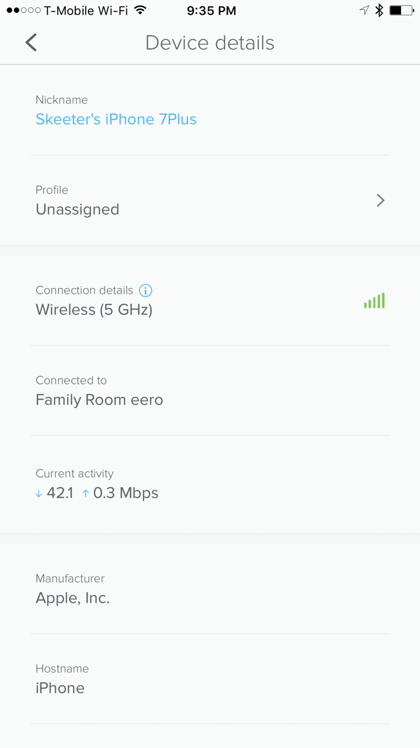

Device Usage Statistics
Hey guys a nice update on specific device bandwidth  usage and thanks to the team for bringing us a step closer towards QoS with the 1.5.1 app update.    This will definitely be useful and from a new feature request would love to see either via the app or a web portal the ability to cap total usage or bandwidth. My idea would be to either completely stop the device or  once threashold is hit then downgrade service.
Additionally have the ability for notifications either via push back through the app or email alerts with reporting.  What do you think?  Anyone else interested in something like this?

    All my devices are showing as idle when I know this not to be the case.
    Does it take time to update within the app?
    • lgreenberg
    • 9 yrs ago
    • Reported - view
    Edit - 2 hours later and now it's working!
