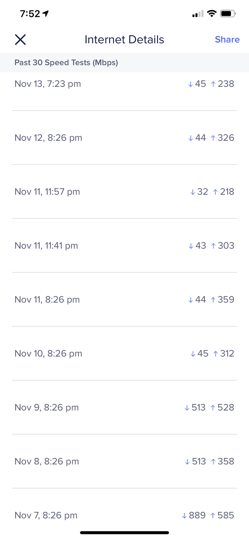

I do not have the exact same problem but I too have had issues since the newest update. I had a stable eero setup for 2 years. Last week, speed issues being throttled to 50Mbps (down from 800+). I spend a long time on the phone with eero support and they were not able to solve the problem. I have since deleted the eero network and rebuilt it with same results. As posted elsewhere, I have taken other variables out of equation. I bought new switches and cat6a cables which did not fix the problem. If I disable the eero and connect directly to the AT&T modem, I'm back to full speed on gigabit.
