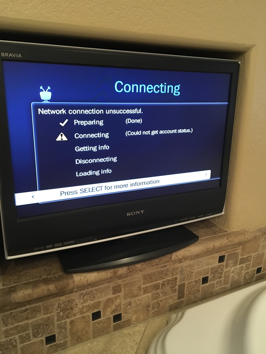

TiVo used with eero and can’t download program data!
This is allegedly a known issue but hasn’t been fixed for weeks now.  I’m probably ditching my eero today... 😕

    I am running into this issue now. Opening the ports required by Tivo did not resolve the issue, the Tivo will pass its port check and DNS check but something around the account status check fails. Question for everyone with the issue: Are you using you ISPs DNS or Eero Plus or some other provider?

    Long time Tivo user and eero user here. I too have a problem connecting to the TiVo service. But - my TiVo is connected via ethernet. The TiVo goes to a switch directly connected to the router and does not interact with eero. On my network, eero is in bridge mode, with an Edgerouter ER-X doing the connection to my fiber ONT and it also does the DHCP work.
    I've been struggling with this issue for some time and I'm pretty much convinced it's a TiVo issue. My Bolt has this issue (on ethernet) and my Tivo Series 3 (on WiFi via eero) does not. I can force a good connection 100% of the time by going into my TiVo network settings, see that it failed, then force a new connection. That will also fail. Now, go back when you see the failure screen, and connect it again. It works for me 100% of the time. The connection step always fails in "Getting account status".
